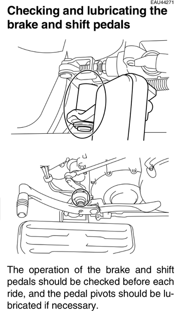

Lubricate the pivot shaft of the foot shifter. It's probably dry.
(Not WD40, but some real oil.)
You'll find it in the owner's manual.
Last Edit: 2017/05/18 17:49 By BikerRon.
' width='450' border='0' style='max-width:450px; ' />

I lubed the shift lever's pivot shaft today using some red wheel bearing grease (the old lube was grease, not oil, so that's what I stuck with). I'm not entirely sure how this could cause the problem, though, because the shift lever moves quite freely and wasn't binding or anything when trying to shift.

How did you pack grease into to pivots??? All it take is a little spray lube under the rubber covers and into the pivot joints. If you packed red bearing grease into either of the pivots could be adding to the issue. Red bearing grease is a little thick and sticky for that type of joint.
I think he just used the grease on the pivot shaft, down by the left foot board.
I feel kinda silly. I always try and make sure to use some grease down there when I have it apart, but I've never thought about giving a squirt of lube under the rubber booties at the knuckles on the arm itself. DOH!!!

Whenever mine starts to acts up a little that is the main place I spray with lube. Even a little WD40 under the rubber boot frees things up and lets it shift proper again. WD don't last all summer but it works for a couple months.
