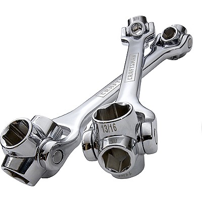

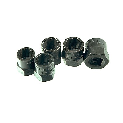

I'm also thinking about trying something like those Craftsman tools designed specifically for stripped bolts. Has anyone ever tried the the Craftsman Bolt-Out Damaged Bolt/Nut Remover Set
Or maybe even one of these: Craftsman DOG BONE™ Metric Wrench
I'm just wondering if either would fit in the limited space around the drain plug or in between the plug head and the frame. If anyone has experience using either of these tools to remove the left side oil drain plug, please let me know because I'd hate to spend all that time and money, just to find out they don't work. As it is, I have a vice-grip and set of flat wrenches I'm hoping I can return.

Im thinking something like those Craftsman tools designed specifically for stripped bolts. Anyone every try these: Bolt-Out Damaged Bolt/Nut Remover Set
I'm just wondering if they'd fit in the limited space around the drain plug or in between the plug head and the frame.
Again, I'm wondering if they'd fit in the limited space. If anyone has experience using either of these tools to remove the left side oil drain plug, please let me know because I'd hate to spend all that time and money, just to find out they don't work. As it is, I have a vice-grip and set of flat wrenches I'm hoping I can return.
I dont think you would have the room to use the dogbones. You may be able to use the sockets you posted only cause you can use a boxend on them (nice tool to have around the house anyway) but like curt posted with the vise grips that should do it but I would get the shorter fat nosed kind they seem to have the cut outs in them for something round right in the jaw. Also if you can find one small enough I have used a pipe wrench to get rounded fubar bolts out.
