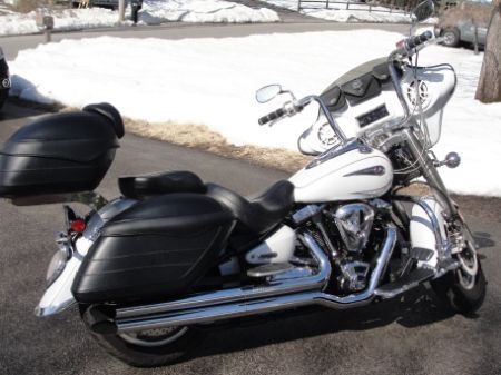

Re:Drill the Stock Exhaust (stage 1, 2, 3) 6 Years, 1 Month ago
FYI I didn't even take the cone out. Just drilled through the cone and the first baffle. It is a pain though because the cone is very hard.
