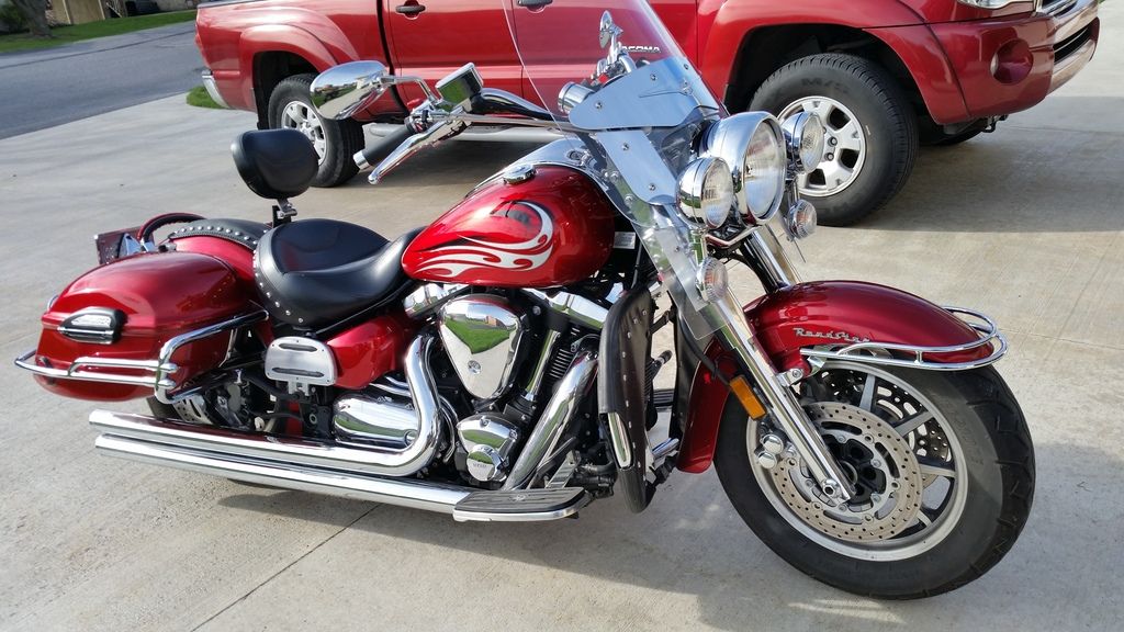

i watched a guy on you tube wrap the baffles with fiberglass pipe insulation to make quiet baffles.
seemed the same thing as the quiet baffles i put on my sportster.i tried it and it does seem quieter.
he recommends regular muffler material since the fiberglass burns out.

Hey Gennaro, that's a good-looking bike.

Hey Gennaro, that's a good-looking bike.thanks doc v
