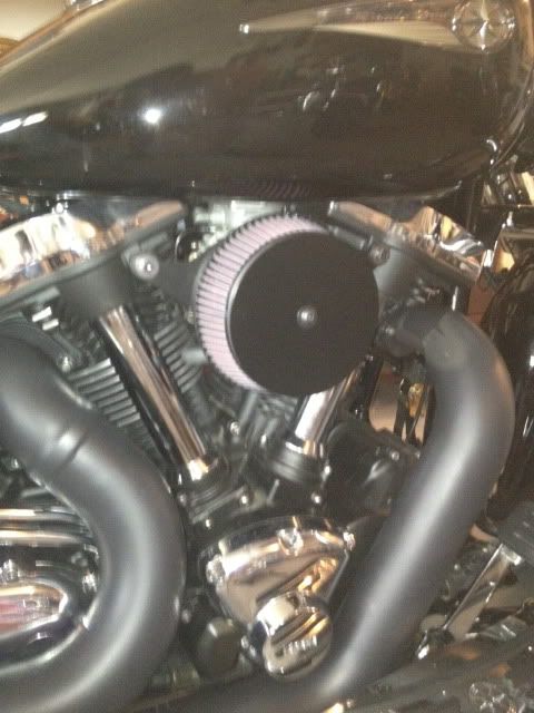

I use the k&n and the brackets were simple. I found 2 little strips of stainless and drilled 2 holes in them....used the stock box bolts...done! Sets under the tank...cant even tell its there...all for $42.
