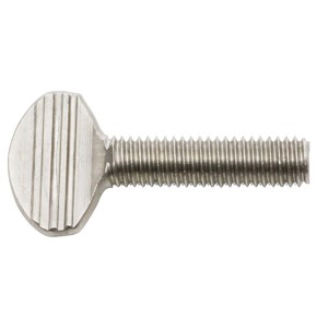

OK, so pulled this image off the net. I took a thumb screw like this in 5/16-18 thread (had some laying around) and 2ea. 5/16-18 nuts. Put the nuts on and jammed tightened them together toward the outer edge of the threads. Then proceeded to massage the thumb portion on the bench grinder to slightly thin and re-profile the top edge to better fit the slot of the filler cap. Result is you can put a 1/2 inch socket on a ratchet and get good pressure pushing and good torque loosening up the cap at the same time.

Good idea Rod, but in a standard thread? Respect the Metric bike, man. They do sell spade head thumbscrews in Metric sizes too, you know

I dressed up a 1 inch wood chisel with a grinder. Add a 12 inch crescent wrench if needed..can't be beat ...........

Well, we are a bunch of cheap bastards with our Roadies like i said, just had some in SAE lying around so used what was available. Who knows, the idea might take off and I can make a bunch in metric, have them chromed, then go broke trying to sell them at just under cost
