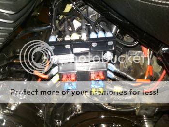

Finally had some time to install my Rivco Fuse Block today. Did a great job cleaning the mess of wires on the battery. Removed all inline fuses on the accessory leads as they are fused once they are ran into the fuse block. Spent a good amount of time soldering and crimping but it was all worth it in the end. Big thanks to Tim (deadlion) for sharing this mod with me and guiding me along the way.
Now for the ooops. After all wire ran and bike put back together, I can't fit my side cover back on without a little bit of force. Feels pretty tight behind it and don't want all my work to be FUBAR. So Tim, if you read this PM me and share more of your genius with me.

Looks really good that is something I need to do on both bikes as well.

Thanks Curt. I really like how all the fuses are now in one location. Tomorrow I'll revisit the side cover issue.

Good looking install. You might try small plastic spacers behind the side cover and it should still tighten down. Just a thought.

Buddy of mine (electrician) put a (homemade) fuse block where the tool kit usually goes. Looks good and clean.

Good idea but that spot is already full... Damn accessories!
