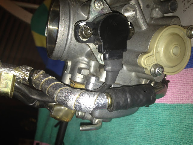

does the black flex line go on the length of fuel line closest to the carb. took it off and forgot.
also any tricks to proper routing of the fuel line to avoid rubbing/wearing on the wires?
and finally, the choke cable has swivelled and rotated quite a bit during my work. do i need to take apart and adjust anything?

The starter jet is nothing but a plug on certain year bikes. So don't worry about not being able to see thru it. The web doesn't really matter so don't worry about it but just an FYI I bent my metal line so it went directly thru the middle between the jugs so it wouldn't get so hot. I will warn ya now it is hard to bend.
