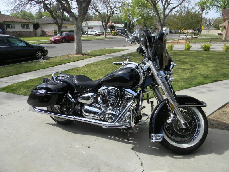

You mean something like this? That's the fender I bought from J&P

Mine came off a 2010 Roadking. Simple enough to do. Just cut off the original mounting tabs then drill your own hole in the fender and a few spacers and you got it. I love the look.

i cut the mounts off the hd fender & welded it to the top of my factory fender (4 small beads) friends have said it's jimmy rigging. my response it this.quiet a few distributors sell fiber glass fenders than must be epoxied to the existing fender ,usually to extend the rear fender or a filler for a bagger. i basically did the same thing except to the front and it cost me less than $100 for fender,trim, and light.
