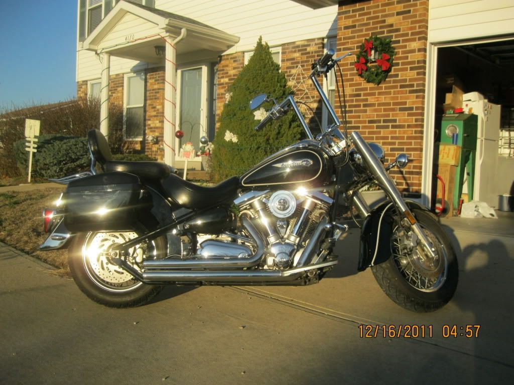

I installed 10" Z bars, ran the wires thru the bars and I have 4" risers with 2" pull-back. They are DT risers from JP Cycles. My stock cables worked, but they were at there limits so I went with 4" longer stainless cables. It was easy to install, gives the bike a real nice look with the stainless and wasn't too bad in price. If you go to ebay, the dealer I used was GT motorsports. They custom make your cables to your specs. Hope this helps and good luck!
Last Edit: 2012/06/23 07:37 By RSTAR99.
#507653
RSTAR99 (User)
Posts: 224
Re:10 inch ape hanger question 11 Months ago
I have changed the headlight and added a stainless plate behind the headlight since these photos were taken.
