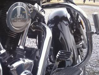

Kai_Sayson wrote:
Yup cut it in half and put a chrome kuryakyn brake cover on...
Very nice! Thanks Kai.

That does look good Kai...

Cut mine in half, and found a h-d pedal with set screws.

v star 650 pedal is a bolt on and half the size, mort ps. i,m talking just about the pedal not the arm it bolts to. mort

Took a little trim, but 15 minute job.

SKWEARpeg wrote:
sigmund wrote:
the brake pedal from and 1100 will fit the R*. saves cutting it down and then you know the new pad fits.
If I understand correctly, Yamaha uses the same lever and spring loaded pivot on both the 1100, and the RS, but just different size pedals? Yes?
Yes

Bought a Royal Star brake pedal on Ebay for $15. Switched it out for the R*. Same pedal, just not as big. Gave me more room on the R. side floorboard for my big feet.

I was thinking about that also, but I think I'll go with an extended lever instead....moves the pedal farther to the front and out of the way of my foot....
i think thats a soft brake arm. i like that over cutting it down but there is a artical you can read that for pretty cheap you can move the whole assembly forward and get the same thing for about $100 less
