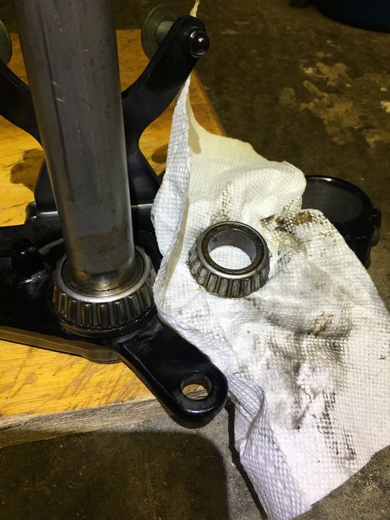

I have gotten to the bearings and yes the two nuts were loose thats what was causing the pivot play. I was wondering if the bearings I have here are factory or they were replaced, i ordered all balls bearings but these look just like them.
Please take a look at the photo and let me know what your guys think.
FYI. the bearing races do not look marred at all so I am thinking of just putting it all back together, there may be a chance this guy that owned the bike before me might have had them changed.

If you don't have any pitting or corrosion, pack your stock bearings and keep them. They are good bearings, just notoriously dry, as stated.

there is no pitting or corrosion on them, the races do not have any divots as well. Are the factory bearings just like the all balls bearing style?

Yes they are. I have used several All Balls kits in various bikes and locations. They source from the better bearing manufacturers in Japan. Heck, quite possible to even land with the same brand as the OEM sourced part. I've never had an issue with bearings or seals from All Balls.
