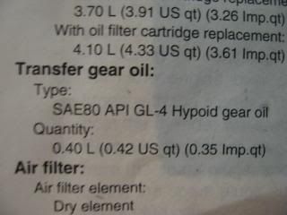

#237510
Diesel Jack (User)
Posts: 14
Re:Transfer Case Gear Lube Change. 1 Week ago
Oil pump for the transfer case is an isolated unit and not part of the engine.
GL-4 requirement would be valid if the transfer case had white metal bushings that could be corroded by older versions of GL-5 fluids, but to the best of my knowledge it does not. Some quality fluid manufacturers, including Amsoil, have stated their GL-5 is non-corrosive, but for peace of mind Amsoil offers a full synthetic 75-90 gear lube with a GL-4 rating. I have a feeling that Yamaha is being proprietory in specifying their GL-4 - it's all they've ever supplied. I haven't seen any on a dealer's shelf for years.
