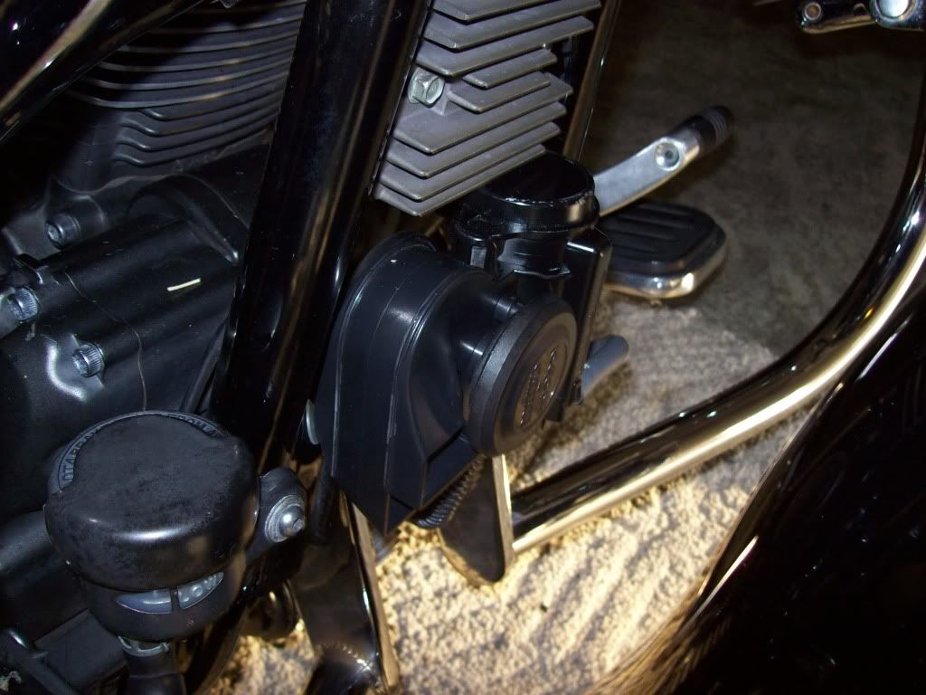

Re:Kuryakyn P-Clamps 1 Year, 4 Months ago
Here's where I mounted my Stebel. where the AIS used to reside.
Greysnake, I am planning to go above the regulator. Do you get a lot of road debris where you have it mounted?
I have mine the same as Gray's, you can see in the sig pic.It's up high enough that the fender protects it, even in the rain.
I used the 1 5/8" so I could make a gasket out of rubber. No metal to metal, and I figured it would soften the vibration.It also gives a better bite.2 yrs and the chrome is as the day it came out of the box. As I still have trouble posting pics I can mail if you like.
I have my horn mounted there. The fender blocks most so there is no road junk.
Most of the road debris misses it. It's worked out good there so far.
