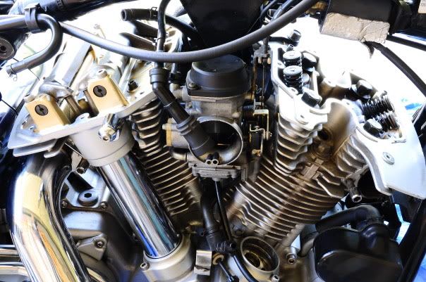

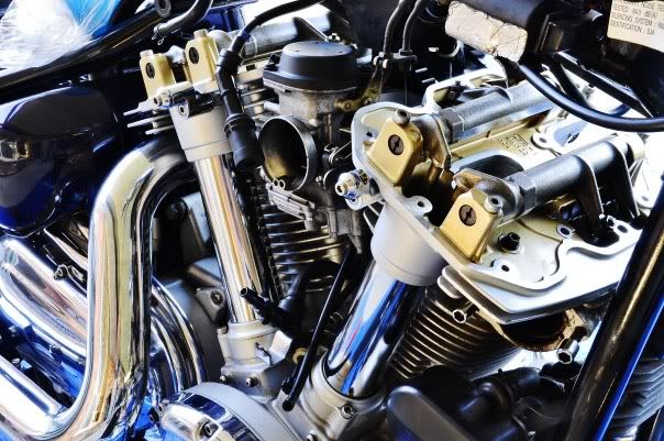

I ended up getting 4 X 1 Qt bottles of Mobil 1 V Twin ordered in and picked them up this morning so I started getting back into assembling the top end, I only got as far as installing the lifters, chrome lifter tubes and the rocker gear. Tomorrow I have to go and pick up my drag bike so probably wont have time to do much anyway, maybe just adjust the rockers, even tho these bikes have hydraulic lifters there is still an adjustment to be made...
