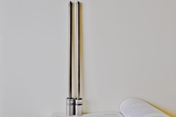

After all the advice given here i have decided to go with the V8 Chrysler lifters, here is a pic showing the 2 side by side. The one on the left is the Chrysler and the one on the right is the Yamaha one, the Chrysler lifter is a little taller however once the pushrods are in place the difference in height is negligible and can be compensated for by an adjustment of the rocker gear...............................
............................This pic shows that the difference in height is barely noticeable, and Yamaha Australia wanted $89.50 each compared to the Chrysler ones at $4.00 each. I personally dont see the $85.00 difference

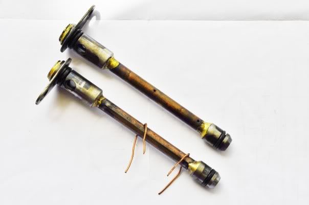

I received my new parts the other day and decided to put the cams back in the bike today In this pic you can see that the old o-rings have become worn and lost their shape thus allowing the oil to blow back past the seal and reduce the fine spray of oil to the cam lobes.

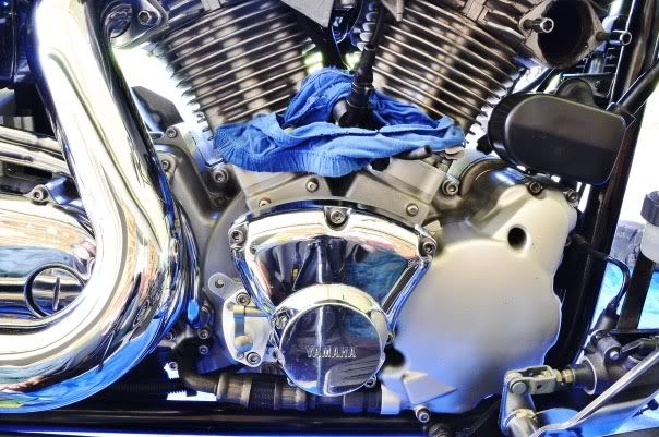

.........................Before i started i removed the left foot board and cover to access the ignition timing marks so number 1 cyl would be a TDC.
