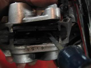

OK re install pads and compress pistons into caliber I use a screwdriver or a set of channel locks with some old inter tube to protect the powdercoat. Keep your system sealed or doing this will unload fluid on your tank.

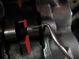

You will see the rod that hold the brakes in. This tiny clip (1 of 2) once removed allows the rod to be pushed through and the pads to fall free.
Pushing the rod through with a screwdriver. (Doing this with common tools)

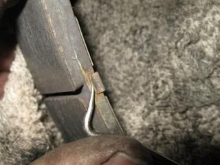

There is a backing on the brakes, remove, clean and install on new brakes.
Get your pick and press here and the backing will come off.

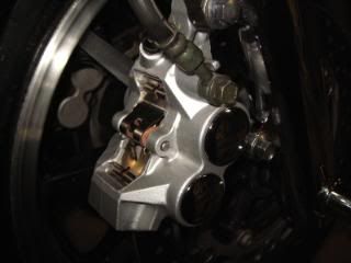

And carefully install the caliper back onto the disc. It will only go on one way, with one pad on each side of the disk.
