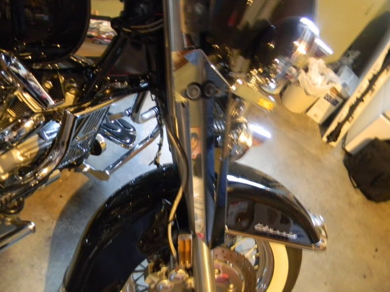

Here is a few pictures of mine installed. It was from a Roadking with only 2 mounting holes. I cut the top part off and mounted it to the bottom hole with chrome washers and a black rubber washer and its been on for 5000 miles and all good. It works good enough for me for now.
Thank you for the pics. I never would have thought that one bolt would hold them with all the wind.

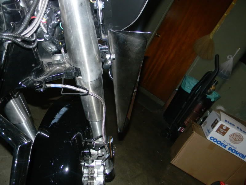

Here is a few pics of my lowers mounted. The one taken from the rear shows the chrome spacer up top with a couple rubber washers behind a chrome washer. Hope this helps.
Here you go.
HD Lowers
Great pictures. I have a good idea now of how they should go. I almost installed them backwards Where did you find the nice chrome spacers?

I got them at Ace Hardware. Menards is also now carrying a pretty good selection of chrome hardware. You will like them. Before I installed them I couldn't ride over about 50 mph. The wind came up and bounced my glasses all over my nose.
