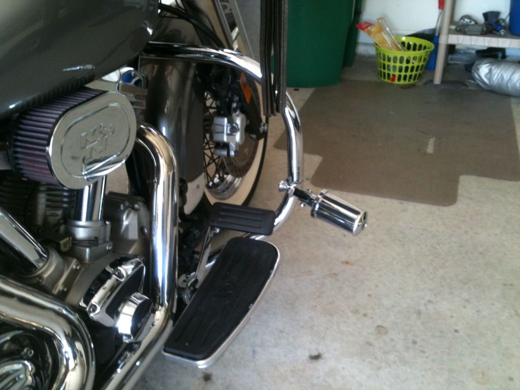

rphazen (User)
Posts: 895
Re:Floor board spacers? 1 Year ago
Doc_V wrote:
, but I I agree with Irishman, the right is less comfortable than the left, mainly because of the brake pedal.
That's what I think. So I use a vstar 1300 brake pedal rubber and cut down the Roadstar's metal part it slips on.
Gives a little more room for the foot. Yamaha part # 1D7-27285-00-00 in case anyone wants to know.
Thumbnail clicky:
Looks like it fits lots of Yamaha's.
http://www.boats.net/parts/detail/yamaha/Y-1D7-27285-00-00.html

#491902
rphazen (User)
Posts: 895
Irishman wrote:
Got a pic?
who me?
got a good comparison pic in my previous post of the vstar and Roadstar pedal pads.
here's one with the vstar brake pedal pad on the bike.
compare this pic to Rev's photo in previous post with stock brake pad.
