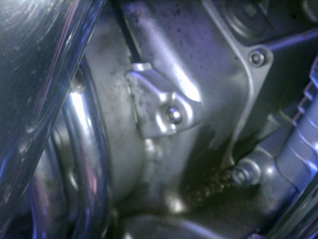

#493447
Re:Speedo and fuel gauge issues 1 Year ago
Is this it?
Or this?
#493448
Posts: 4783
polishdog wrote:
Is this it?
Or this?
That's it.
#493449
Posts: 4783
Oops. top picture
