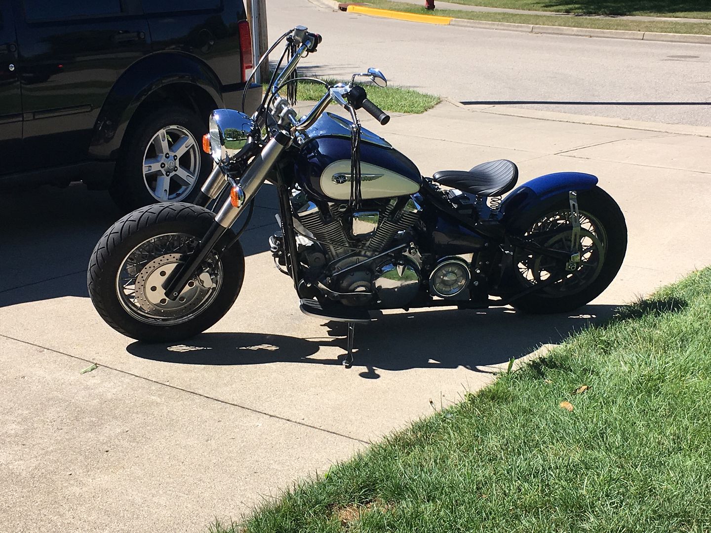

Well thanks for the tips and help here! Unfortunately, no amount of hammering or lifting was going to get this axle out. Apparently, the guy I bought from a few weeks ago possibly changed or had the bearings changed out and put them back inside out of order so after driving it for so long, it welded the bearings and collars to the axle. I've attached a picture of a large chunk of melted metal. What's crazy is that thing drove just fine and no noises for the 250 miles I've been riding before wanting to replace the tire.
Anyway, cutting it was the way to go. Now I get to spend a crap load of cash on small axle collars and wheel clutch hub But at least I found it now instead of broke down on the road some day.
But thank you guys!
