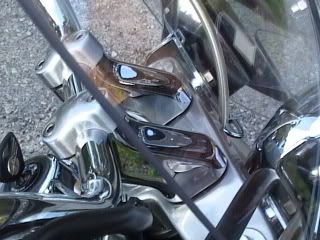

just installed these risers....made the world of difference...rode 300 miles sunday....felt real good...before I could stand about 90-100 before the sholder pain...
